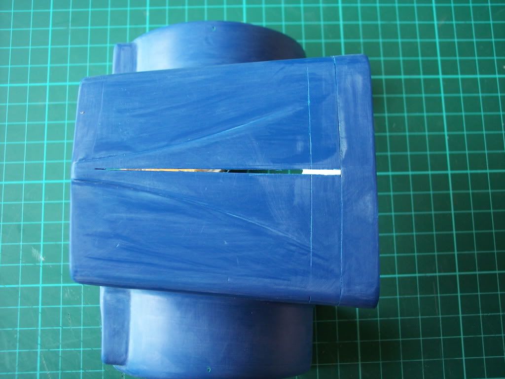

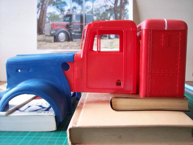

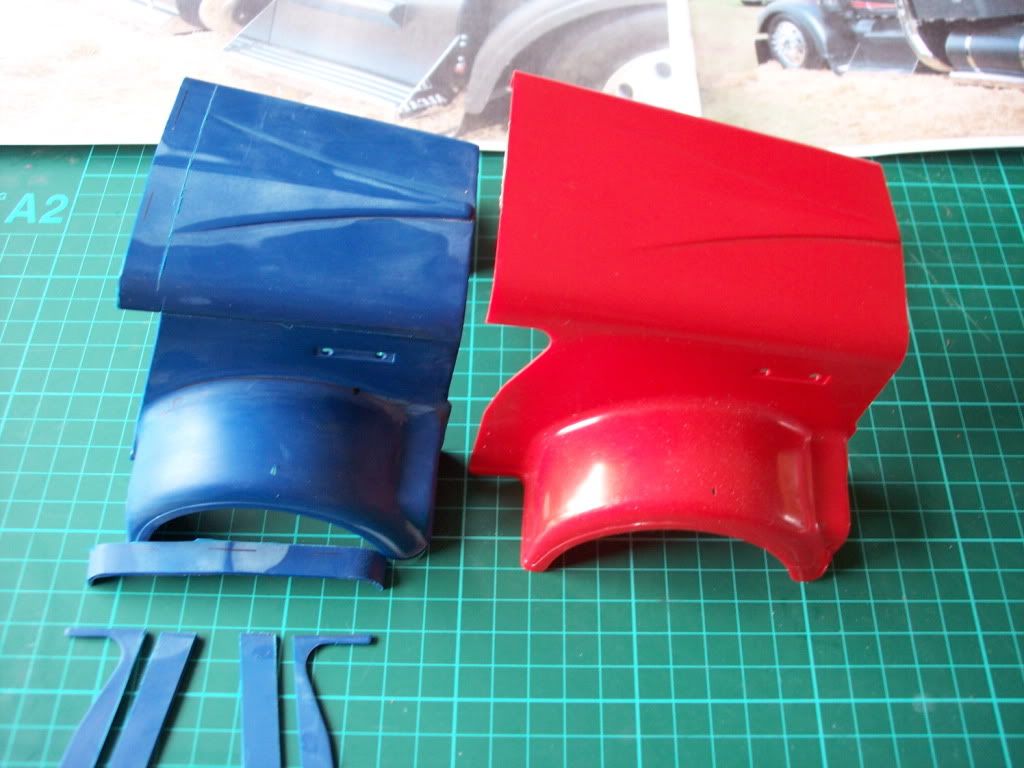

and here is what I have done so far, 1st was to chop the bonnet down by 11mm, and realign
Then cut the sleeper down to 36inch from the box version which is almost double
This is how it looks as a mock up
Next was the cutting up of the battery boxes
and it looks close to what the pic is, except the paint of course

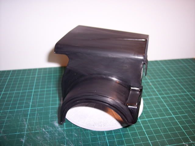

Post by Argosy620 on Wed 10 Mar 2010, 8:15 pm
Thanks for the comments guys,

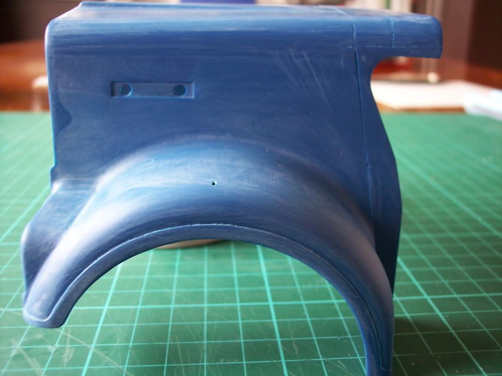

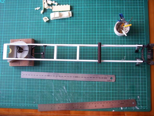

I have done a little to it over the last week, started scratchbuilding the frame, and finished the bonnet, all it needs is a coat of FFP, and it is ready to cast, the FFP creates a nice flat shiney surface so it comes out of the mould better
I decided to scratch the frame because of a couple of reasons, first I would have had to remove all the detail, cause the truck don't have any, and second because I could add a bit more strength to it
and most of the frame is covered by louvres,
here is a pic of the frame rear
I used 15.9 mm I beam to make the frame, just shave one side to give me a C channel
and the stand kit rear end and front end
and here is a pick of the bonnet, here is is sprayed Black and has been blocked back

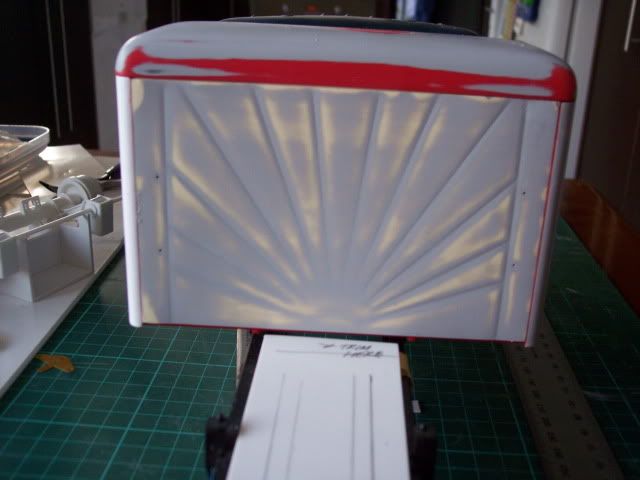

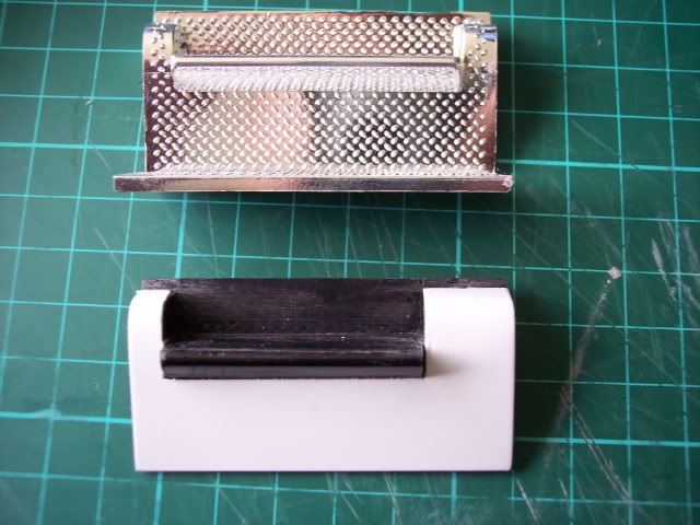

Post by Argosy620 on Sun 05 Sep 2010, 9:28 pm
Thanks for all the comments, it has been a while since I have updated this, so here is what I have done since my last post

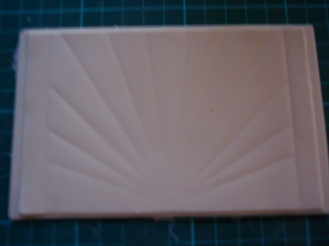

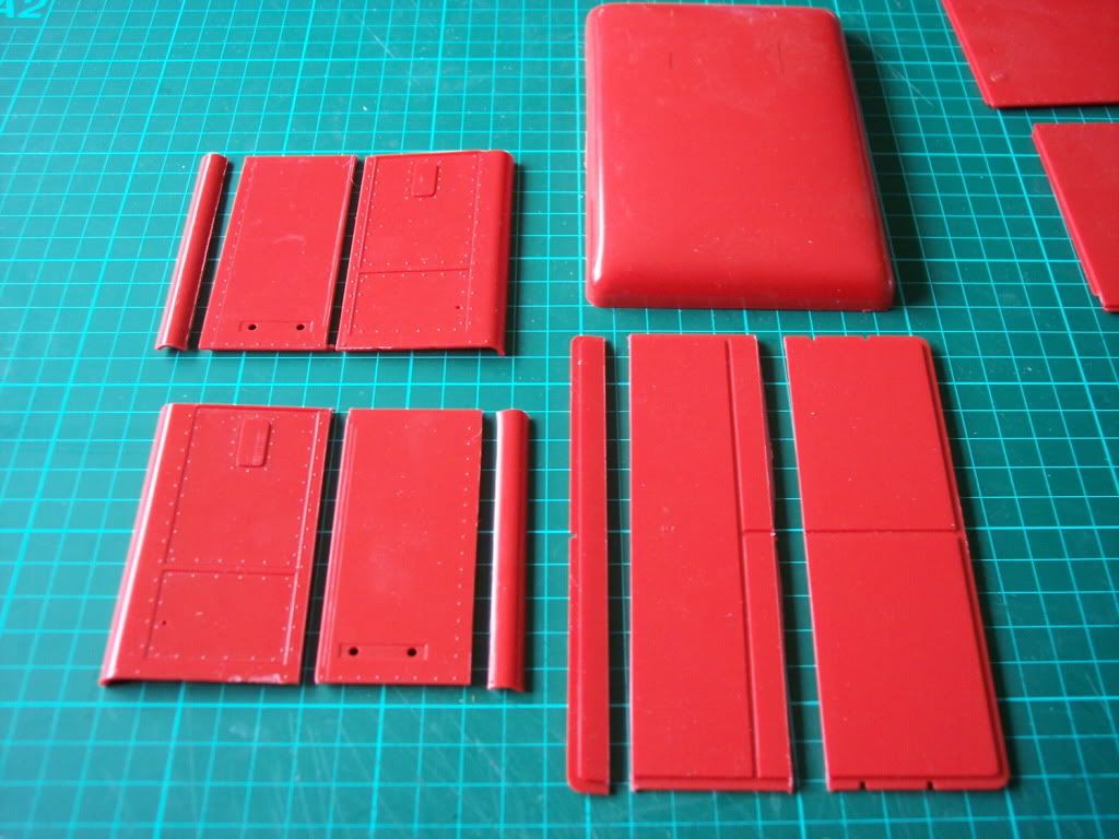

I have completed a few items, but the most difficult was the rear sleeper panel, which I had 6 goes at, I finally got jack of it and had a photo etch template made and used it to press a panel out, which I then took a mould from and cast a panel, here is what I was going for
here is what I used
and the result

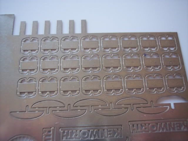

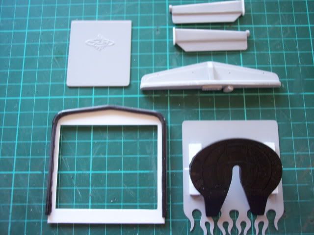

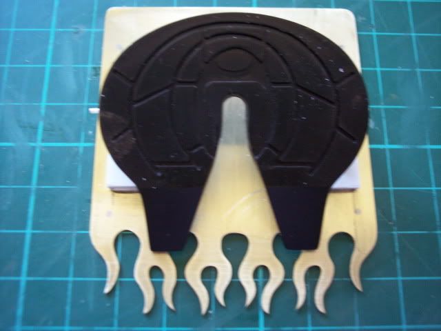

I invested a lot in some photo etch parts, as I think they really make it more scale like,here are some of them
some more parts, these where scratch built, console, flap mounts, flaps apart from the turn table plate

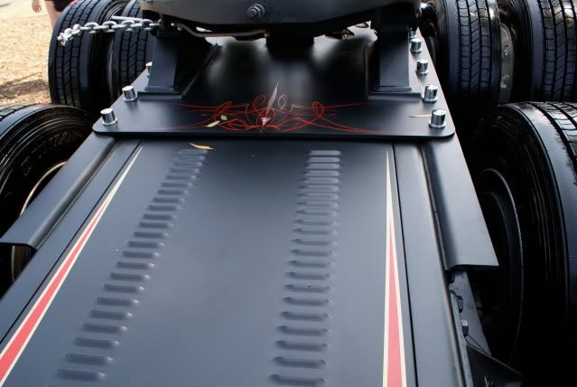

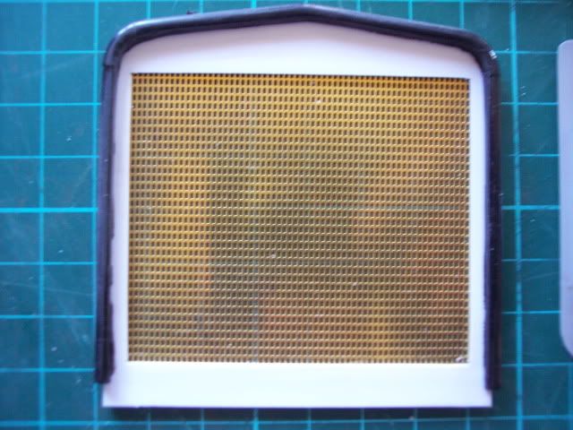

Front grill was modified to suit the new etch grill, and will have 9 up rights fitted, I will then have it chrome plated
Next on the list is the louvred deck plate, this should be fun
