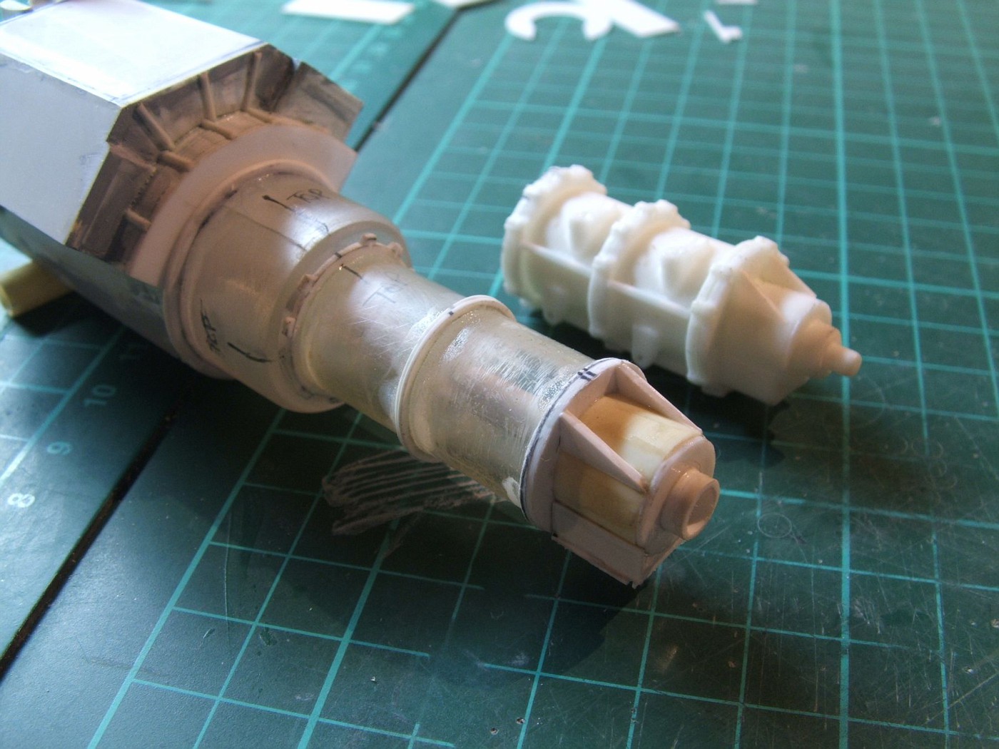

MOTOR....
The engine is coming along nicely.
Heads are made, still need to make a rocker cover for one side. Embarassed
Intake manifold for the blower is started, and an update on the blower.....
Well, I decided on a Kobelco Superman style, as I had the blower from a 1/12 Corvette just laying around... Rolling Eyes Laughing
It needed to be widened, as well as a new tail section made up.
New dizzy/mag taking shape.....
Motor overview.

Ok, back to the motor......
The blower is coming along.
Made a new front cover plate, it will "bolt" to the main case.
"NEW" parts ready for trial....
Test time.....Yep, starting to look like a Kobelco. Very Happy
Have the rear cover plate almost finished now. Just need to add a couple more items to it, then some pics..
I've been re-working the injector hat a little too. Found some better reference, so have altered it slightly..

The resin Lenco I was going to use, got ditched in favour of one I made myself.
Trick Titanium clutch can and Lenco were both made from old plastic bottles I found around the house...
The clutch will be linked to the pedal assembly as well..
