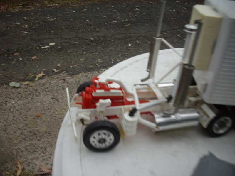

This is what i'm currently working on, AMT rig, shortened the frame, a friend taught me some lathe basic's & i machined up the fuel tanks & caps (got to drill the holes to fit the caps yet) & put on aluminum straps. The trailer is an Italeri 48 footer cut back to 40 feet. I made a mold & cast one of the rear doors then cut it to fit on the side. Made the king pin on the lathe. The 2 hole Budds are from Jamie aka 73gmc454 (Thanks)(Model Cars Magazine Forum). I,m trying to find wiring diagrams for truck & trailer & Aluminum wheels for the truck. The original inspiration came from Missing in Action's Bj rig (thanks))(Model Cars Magazine Forum). Feel free to comment, good or bad, tips useful.

When i rebuilt trailers back in the 70's you would run the 7 coloured elect wire from the plug down to the back on the inside of the frame to a junction box which was normally mounted on the back of the panel where the number plate is . Then you would run the clearence light wires from the junction box up the outside of the frame to the front and then run wires from the side lights to those wires where you used little blue joiners that clipped into the wire supplying power to the clearence lights . You also ran the stop , blinker and parkers from the matched coloured wires on the junction box .
I think the wireing for the truck is a huge job ! . aus

Thanks for the kind comments, i meant the plumbing for the brakes etc. Thanks

The air lines at the front of the trailer, one on each side of the electrical wire plug go along the inside of the chassis with the power lines . They then go to the side of the breakaway valve , (the valve on the front of the air tank ) and the hoses come out the bottom to each brake booster . Simple idea hey .

Thanks for the plumbing tips Scummy & Thanks Mutley for the Auslowe idea, unfortunately they don't have them, have been able to get some from the US though but not cheap.

Ok, here's a bit more, my friend made the air cleaner for me & showed me how to use the mill to drill the holes for the fuel tank caps. I made the air tank for the trailer out of some scrap plastic rod my friend had laying around his workshop, just got to build the legs for it, the tank next to it is a resin peice i bought from the US (you can see why I remade it). The exhaust was bought from GR decals, just have to shorten the stacks. The truck frame was shortened by 65mm.
