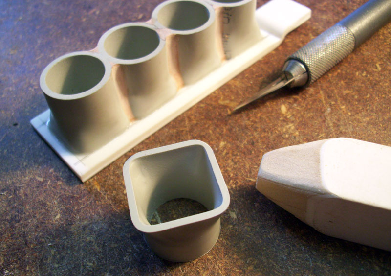

A little more work on the engine bits, all the ident letters and numbers done in "Slaters" model railways plastic letters.
 Ranging from 1.5 mm to 3 mm. Pics of Muncie trans and Potvin outlet side.
Also made the Hilborn type injector out of PVC electrical conduit, heat formed with a candle and piece of wood.
