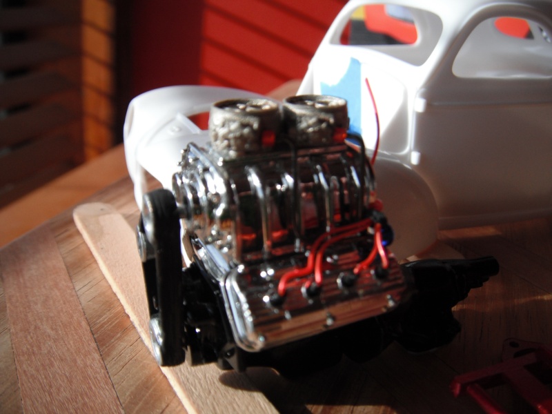

My plan is to build the toughest Willy's i can with what bits i have laying around.
I have a couple of versions of this kit, including the newest monogram version, but they all have the exact same wheels, just different decals.
So , first job was to find a different wheel/tyre combo, and then upgrade the blower to something a tad larger, and a pair of pro stock Dominator 4bbl carbies.
Chassis is done in Brandy Wine Nail polish, but i thing the body will be done black??, will decide a bit further down the track.

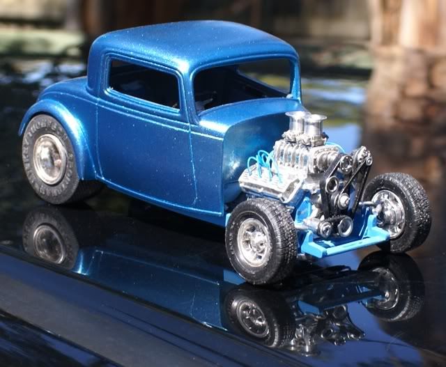

It's tricky to lower the Willys Street Rod but it can be done.
If you want it to still steer and for the engine to fit you have to treat it like a 1:1 car and re angle the wishbones (A-Arms).
I lowered the front when I stuck this chassis under a '32 body.
Didn't take pics while I did it though.  That would have been far too helpful.
Here are the only WIP pics I have.
It's all a bit hazy now but I think I turned the cross member upside down and I had to relocate the upper wishbone mounts as otherwise the castor angle was severe.  To get the tie rod to clear the chassis I cut the ends off and added wire sections which I bent or dog legged upwards.
HTH

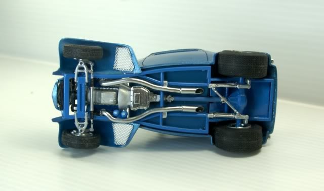

B, I z ed the frame at the front just the height of the rails.

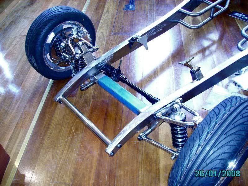

While we're on the subject I came across this pic while sorting some of my photos earlier.
Mustang 2 type IFS on a deuce chassis.  It shows that Revells' wishbones are on the fat side but I suppose if they were accurate they'd be a bit flimsy.

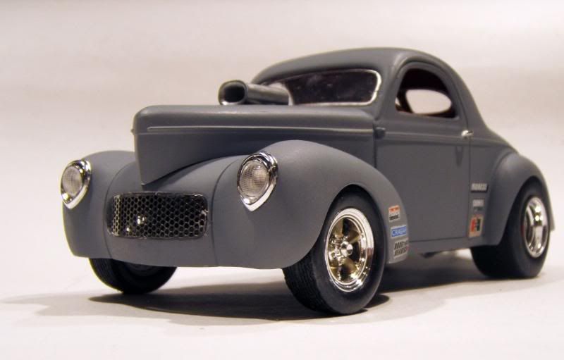

Thanx to you both for all the details and the basic approaches. All the cars shown so far are plenty low enough and the solution seems pretty straightforward. As long as the axle centerline is above the frame rail I assume it's mission accomplished! I think I know what to do now. It all seems so obvious when you know how...
For some reason when I built my stock stance bling-free Revell street-rod Willys I completely missed the posable steering aspect. Is it a feature of the kit?
In any case, in the interests of keeping the hi-jack alive here are some suitably irrelevant pictures of my "hi-boy". These days I can't stand the tall (but not tall enough gasser-wise) stance, but I do like the utilitarian primer and metalizer look. It's an aspect that must be in the DNA of this car because Brett took a similar approach. It seems to work slammed or unslammed. Something to re-visit in the future... But slammed is better IMHO! And next time it will be shiny!
Build on DeeCee!

zenrat wrote:While we're on the subject I came across this pic while sorting some of my photos earlier.
 Looks Very much like the Rod-Tech IFS set up my wife's '33 is running.
Re: 41 Willy's *Some Details.*
Post by zenrat on Wed 21 Aug 2013, 7:16 pm
Could well be.  I took this pic at the 2008 Victorian Hot Rod Show.  Think it was on a trade stand.
