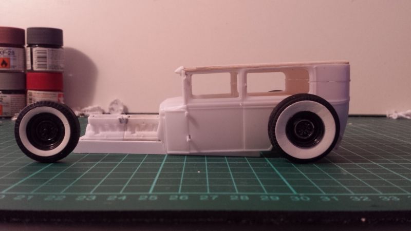

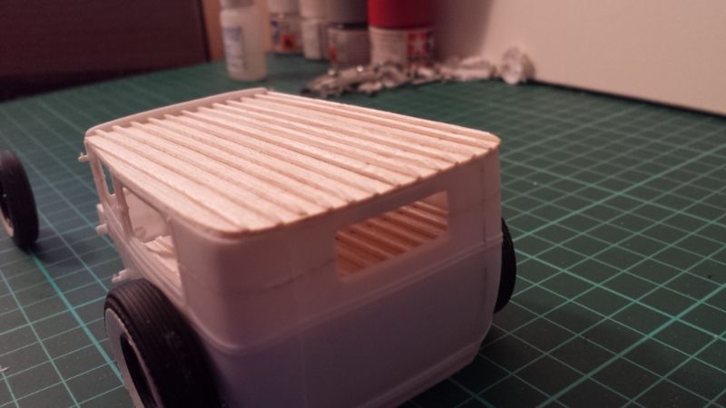

Here's whats been keeping me busy lately. Balsa wood is my new favorite thing. Havent decided on front suspension yet, but the back is single leaf setup Smile

Post by dv8v8 on Wed 29 Jan 2014, 6:17 pm
is that gunna b a straight 8 or a 12 ?

Post by zenrat on Wed 29 Jan 2014, 10:46 pm
Soy sauce is good for staining balsa…
…and my tee shirts.
Looks good slowly.  That looks like two 4 bangers which would make it a straight 8 in my book.

Post by RetrospectKustoms on Fri 31 Jan 2014, 10:57 am
Looks neat, Like your wood work.

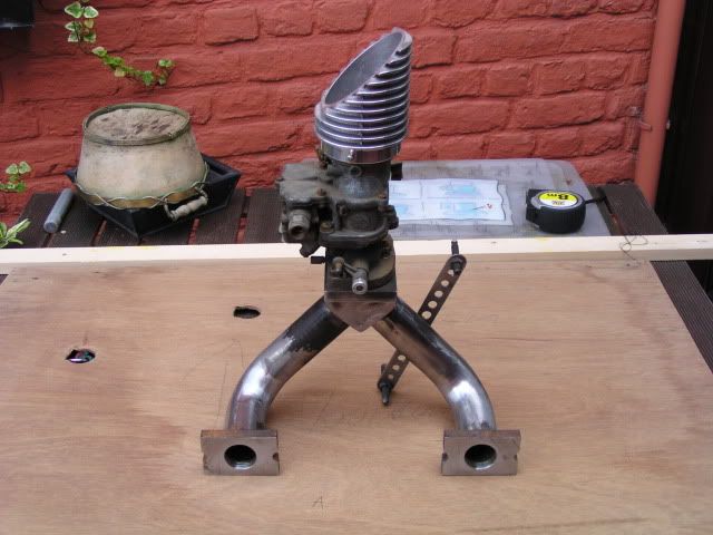

Post by zenrat on Sun 02 Feb 2014, 10:59 pm
That's right Slowly.  It's called an updraft carburettor.
The stock 4 banger is a flathead engine with cylinders 1&2 and 3&4 having siamesed intake ports (one hole connects to two cylinders).
Here's a stock one.
Here's one with a twin updraft carb manifold (thoughtfully colour coded pink).
Here's a single downdraft carb manifold.  You could easilly modify your kit manifolds into something like this by cutting the carb and vertical tube off and gluing it back on the top.
