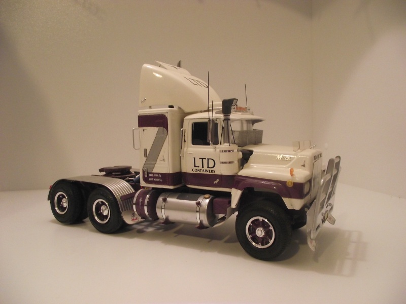

Post by cruiseliner on Sat 02 May 2015, 9:26 pm
Found thes may help with something.
cruiseliner
cruiseliner
Male Number of posts : 191

Post by Deaf as on Sun 19 Jul 2015, 7:47 pm
Have done a bit more on this old girl. There was a fair chance I put this together with tube glue - great for pulling it apart again but made the original build look disappointing. Stripped the paint off using Pine o clean, took a while and a bit of scrubbing but came up ok.
I found an Auslowe resin Mack suspension and used it as a guide to cut the existing wide one down to the same spread. It's still a touch wider than the one on the Cruiseliner but the same as Auslowes so that'll do. Made up and mounted mudguard brackets. Going to use Auslowe resin guards that came ready done in white resin. They are a bit Richie Benaud though, meant to be white and look white until put next to something white- then they turn off white, ivory, wild rice, mottled cream depending on what they're next to Very Happy
I used the Auslowe B model tanks. I sanded off the surface detail (fake chequer plate?) and filled the pressed end detail on the front end of the tank. I then cut a groove in this end for the tube bracket. I also made the top mount bracket for the back end of the tank and added the old front mount taps to the tanks. They may be a touch overscale but the photo makes it look heaps worse.
The old resin cab didn't enjoy the clean up much. I'd like to say I wasn't heavy handed but the evidence suggests otherwise! It's as brittle as and needs a gentle touch (I could be in trouble) but should be salvageable .
A mate found a bloke on another forum doing a Ford LTL in the same livery and he has the decals done. The young bloke has asked if he could arrange another set but so far no word back, fingers crossed!
