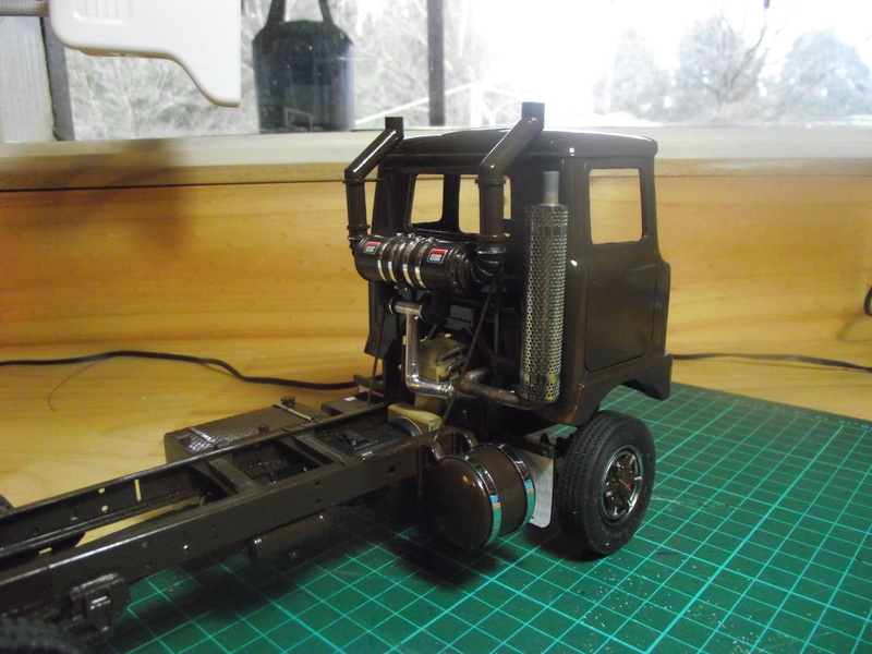

Post by Deaf as on Tue 20 Sep 2016, 5:42 pm
Got a bit more done.
Used the two part chrome nail polish on the engine pipes as a bit of a trial. Came up pretty well considering I used the brush from the polish bottle. Stands up to handling a treat. The twin aircleaner pipe from the bottom of the filters wasn't a great fit. The rounded shape on the black elbow needed a fair bit of sanding to get it to fit  but that lifted the pipe too high so the other end didn't line up with the pipe from the turbo so I settled for the middle ground.
Yep, it sure is a lot of brown but this is a test fit to see where it all lines up so I can mask out for the stripe.
The exhaust heat shield on this was very nice. Finer than the usual ones from KFS which seemed to make it easier to roll into shape. The gantry behind the cab is a real fiddle however. it's made from pretty thin plastic for scale realism but moves and flexes once the resin air cleaners are added and the slightest pressure fitting the engine pipes pushes it all slightly out of alignment. next time I think I'd use metal rod for the stays and maybe some brass strip or even angle on the uprights. Hollow air cleaners would help.Even the weight of the resin exhaust added a very light lean forward.Rolling Eyes

Post by allan on Tue 20 Sep 2016, 7:14 pm
Looking good, Is the cab sitting a bit to high?
Male Number of posts : 9673
Re: F Model Mack
Post by Deaf as on Wed 21 Sep 2016, 9:49 am
Al, I'm not sure. It looks like a big reach up to the door handle but the cab is sitting on the mounts correctly and they line up with everything else so I can only presume this is correct.
