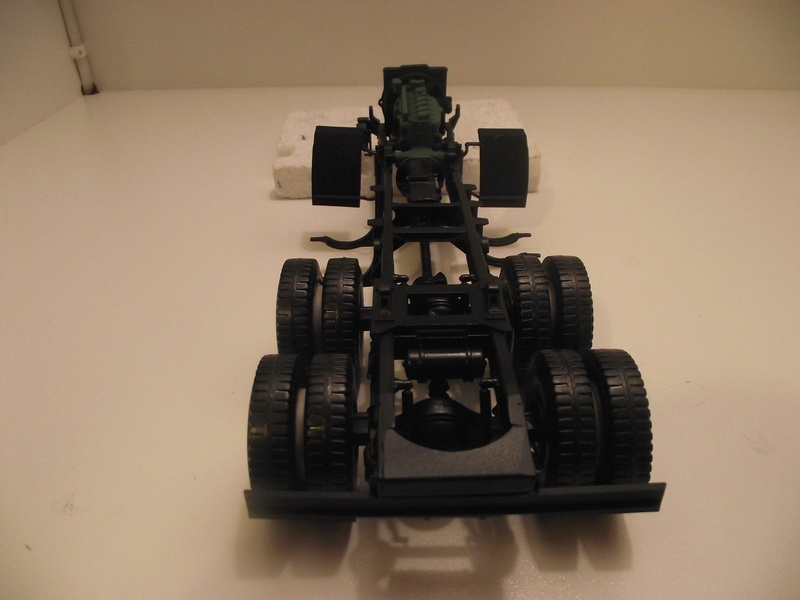

Finally got the 2 halves of this together. It wasn't a happy marriage by any stretch. The chassis rails were different heights and widths and the cross members were also different. I cut the cross member in the front (Volvo) end  and added strip to the top of the rear end to increase the rail height. I used a section of C channel  on the inside of the chassis to strengthen the joint. The cross member here was filed down to suit. I have sorted that twist in the chassis out as well. Guess work was used to sort the wheel base out. Still plenty of tweaking to go on the chassis

Primed the chassis so that I could see if I needed to do more work on the joint between the 2 halves but it came up OK. The mounts for the quarter guards sit over most of the join which helps. The mounts are a little larger than I would normally be happy with but the back of the mounting rod on the guard is hollow so it was a major hassle to detail it up as normal. Used a set of mock up rims to work out guard position so that i could set up the tank brackets between them and the front guards. Still have to put the bracing between the tanks and front axle on. Just need to check I have enough flex in the chassis to slide the engine in with these on.
Auslowe rims and spiders. The front ones are ones I've had forever - cast in the old yellow resin! The rims are painted in Humbrol silver to represent the standard factory colour. I've done the spiders in satin black which is a better match to the finish it had after being in service for a while.
Every engine I found on the net for a colour reference seemed to be a slightly different shade to the next one so I just found a colour that seemed like the average and used it.

Finally have the chassis done in satin black. The front guards will be done in flat black. Few more bits to pick out on the engine then it's right to go in, front axle on radiator and rear cab mounts then onto the cab.
