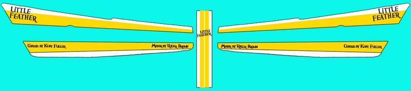

To keep the weight down it runs a bare aluminum shorty body, here supplied by Altered States, with just a minimum of paint accents. I used Krylon Chrome paint to simulate polished aluminum. The [paint scheme is done with decals. I used white decal stock to eliminate the “silvering” that occurs when applying clear decal stock over bare metal style paint. Here are the graphics:

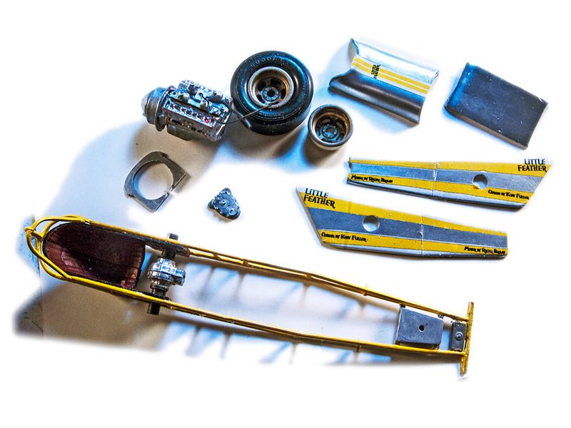

With barely a week to go my bench is covered in subassemblies ready for the final thrash. The motor is partially assembled, the chassis complete with the cut down interior and rear end assembly installed, ready to receive the front suspension and drive train. Here’s a shot of some of the parts:

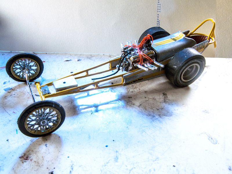

Moving right along. The motor’s nearly complete, with most of the wiring and plumbing in place. The chassis only needs the steering and radius rods to be done. Here’s a rolling chassis with the body and motor mocked up into place. You can really spot the early 60’s 108” wheelbase now that the motor is in place and it’s up on its wheels. The front wheels are finished in Tamiya Gold Leaf on the rims to simulate anodized aluminum lightweight pieces as often seen on these featherweight diggers. The distributor on the motor is a new item from Morgan Auto Detail, a Cirello (or prior to that Schiefer) “Frankenstein” magneto. The headers, wheels and tires are all from the Tony Nancy Double Dragster kit and the fuel pump is courtesy of Altered States Models.
Thanx for Lookin’
B.
