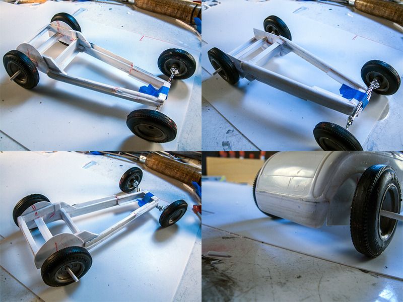

About every two or three years I have a swing at building a full bellypan 32 Ford hot rod. The first one was a gold roadster based on the old Monogram 1/24 scale kit which doesnít have a separate chassis. Since putting a bellypan under a Deuce completely hides the frame when modeling one you may as well use the bellypan structure to s\erve as the chassis. This was the technique I developed for this initial build back in 2010. Unfortunately I wasnít aggressive enough in showing the bellypan and the car landed up looking like a mildly channeled highboy rather than a bellypan car. Then in 2012 I tried my hand again and this time I wasnít shy about showing the pan and the result, this time on a Revell Deuce roadster came out better, with a pretty nicely visible deep pan, although the rear section rose toward the rear of the body shell a bit too much for my taste. Then in 2014 I built a chopped Revell 5-window into a lakes car and pretty much got the visible bellypan look I was after. Hereís a composite photo of all three:
Now itís time for another one. I started out intending to build street roadster but then got sidetracked thinking about using some Old School Indy Firestone tires and Halibrands like the ones found in the ex-Monogram Revell Kurtis Kraft 500 Indianapolis roadster kit. As fate one have it Indycals Decals has issued some super-sweet detailed aftermarket resin versions which are far more finely detailed and properly scaled which sealed the deal for me. The result was that Iím going for a lakes roadster look with a tonneau cover and roll hoop. The Indycals wheels and tires should be here tomorrow but in the meantime Iíve gotten to work on the very extensive fabrication and body work bellypan builds require. Part of the key to getting an aggressive enough looking pan, Iíve learned, is to make sure the curvature of the pan is fairly pronounced. It also helps to build up the real roll pan deep enough so that the bellypan doesnít kick up too much past the rear axle. Hereís where Iím at so far. The basic ď.chassisĒ cum bellypan has been constructed, built up from various shapes of styrene strip and rod, the rear roll pan fabricated and installed, the tonneau cover made and the roll bar fabricated from aluminum tubing. The lower surface of the bellypan will be fabricated once Iíve finished fitting the interior bits and motor. My plan is to do a yellow car with white side panels and bare aluminum tonneau cover and bellypan bottom surface.
These are the wheels and tires Iím getting from Indycals:
Below is my work so far on the model.
Thanx for lookiní,
B.

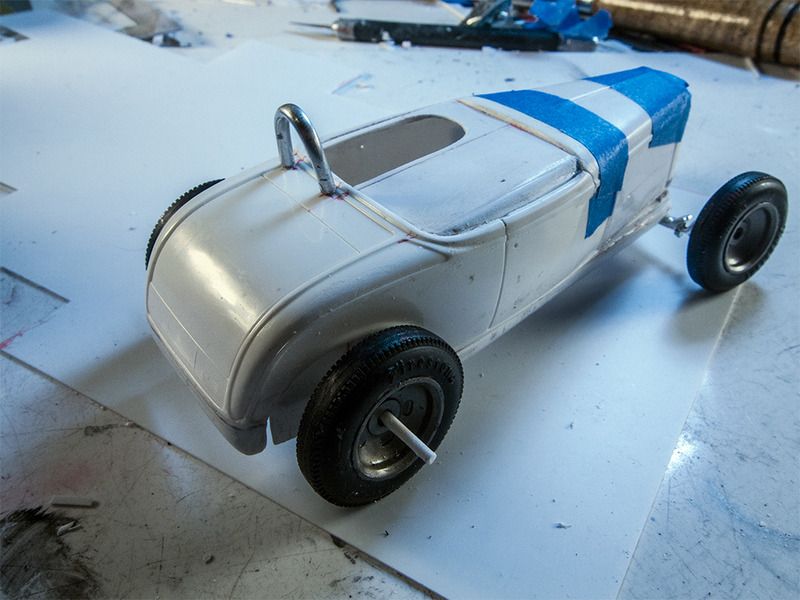

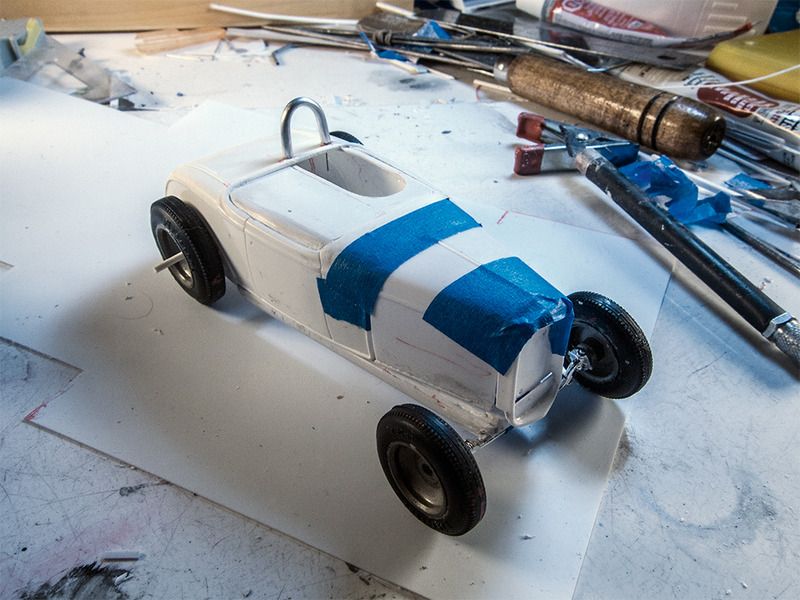

Doing a bellypan hot rod sits somewhere between a scratch build and kit bashing. No kits or instructions for this one! Got some more fabrication done and the tires and wheels came from IndyCals. I fabbed the basic interior bits from styrene sheet and strips and added extensions to the roll bar to represent the interior portion visible from the driverís opening using styrene tube. The tires are painted flat black and the wheels are in white primer for now. I made inner wheel discs from styrene sheet which will be finished in polished aluminum metalizer. The outer wheel surfaces will be painted to match the secondary accent color once I put down body paint. Theyíll most likely be white. The tires will get their decals, which come with the wheel set, at that time. I also fabricated the front axle in order to get the nose down more like the blue roadster shown above. Next up choosing and making up a motor.
Thanx for lookiní,
B.

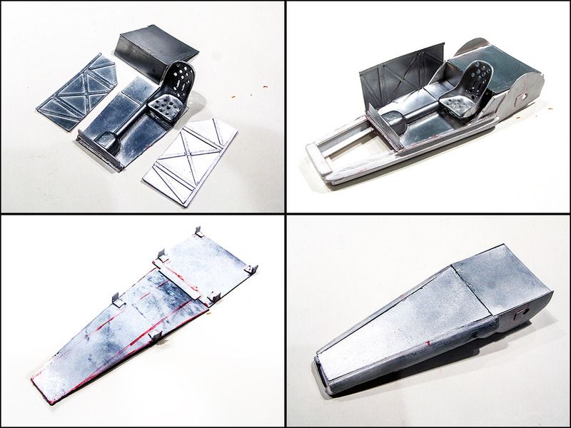

Slow but steady on this project. I got the interior panels and seat (upper 2 images, below), with the exception of the instrument panel, cut, fabbed and finished, along with the bellypan underside panels (lower 2 images, below). The seat is a resin piece from Crazy Scale Auto Parts (http://crazyscaleautoparts.cybrarygoddess.com/). Theyíre all finished in Testors Buffable Metalizer Aluminum Plate which will be a thematic element of the car. The grill will have a solid aluminum panel as well. In keeping with the ďenhanced curbsideĒ approach to the build the dashboard will be fabricated to attach to the underside of the tonneau cover with only those portions that are visible in the completed model getting any detail. Along with making the instrument panel, I have still to determine the powerplant, build it, and fabricate the mounting bits for it. Iím thinking in terms of a top-mounted blown motor, if itíll fit, either a SBC or an Oldsmobile. Itís really a secondary element in this car so Iím struggling as whether to ďsacrificeĒ an Olds for this project. Once the powerplant issue is settled it will at last be time for finishing up and detailing the body structure, then paint, decals and final assembly.

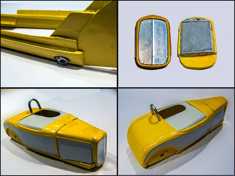

This project seems to have developed a case of the stumbles as Ií,m staggering along in fits and starts. Iíve gotten the basic paint done, a two-tone combination of Testorís Daytona Yellow Lacquer and Duplicolor Oxford White. I also did some detail work on the bellypan, inserting a pair of ovoid holes in front of the rear wheels for the exhaust. With the basic body paint on the photos below include a rough mockup of the body showing the plain aluminum grill panel. Also included is a detail of the grill shell. I banked the radiator with a piece of styrene and finished it in aluminum Metalizer to represent a coolant tank which a lakes car like this would use to reduce the drag caused by the radiator core.
